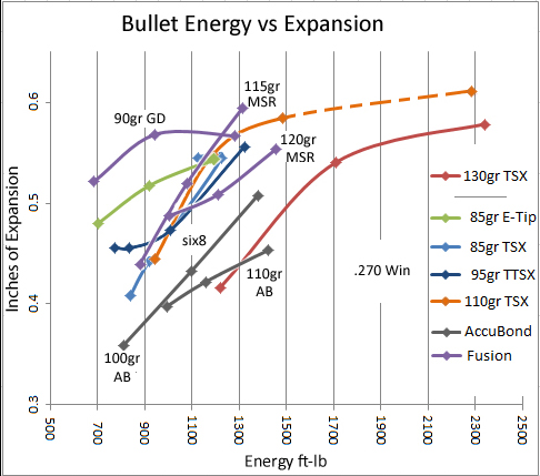

Velocity vs Energy vs Momentum
Here is a comparison of bullet velocity, energy, and momentum. The Barnes 110gr TSX clearly is the leader of the monolithic 6.8mm bullets with respect to energy on target and expansion out to 200 yards.
What Defines Bullet Expansion?
Manufacturers typically advertise a minimum velocity at which a bullet type will open up or mushroom. I have found that bullet velocity is not a consistent parameter in determining when a bullet starts to open up, e.g., the Barnes 110gr TSX opens up and has greater expansion at lower velocities than the 85gr TSX even though they both have the same expansion cavity design with an advertised 2100 fps minimum velocity for expansion. To better understand what is occurring on impact, bullet expansion was charted with respect to velocity, momentum, and then kinetic energy to see if there was any correlation of data. When charting bullet expansion compared to velocity and momentum, there was no correlation. When expansion was charted with respect to the bullet's kinetic energy, there was positive correlation and the 85gr and 110gr TSX matched each other. As seen in the charts below, expansion of monolithic copper bullets is determined by the bullet's kinetic energy on impact not velocity, e.g., heavier bullets at lower speeds can out expand lighter bullets of the same caliber at faster speeds. This now seems obvious after looking at the data - work has to be expended to peel open and fold back the pedals of a solid copper bullet. Work is energy (1/2 mass * velocity ^2).
Instead of one chart showing all the compiled data up front, 3 charts are used to best show the data and build on the observations. Below is the first chart completed which compares just .277 Barnes TSX bullets. 6.8mm tests were conducted at 100, 200, and 300 yards. Bullet tests with the .270 Win were at 100, 300, and 500 yards. This has been an enlightening exercise and shows why the 85gr TSX has a limited range. Note, the 85gr TSX was tested twice with two different powder weights during load development.

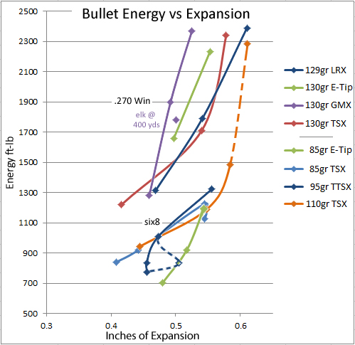

6.8mm Monolithic Bullets with Ballistic Tips
The chart below has the test data add for the Nosler 85gr E-Tip and Barnes 95gr TTSX which are tipped 6.8mm bullets designed specifically to open up at lower velocities.
85gr Nosler E-Tip - 2845 fps (31.0gr AA2200) [BC 0.273]
95gr Barnes TTSX - 2890 fps (30.5gr AA2200) [BC 0.296]
Caution - these loads worked in my rifles but this is no guarantee that they will work safely in yours.
Observations Regarding 6.8mm Monolithic Tipped Bullet Expansion
o Both bullets out expand the TSX bullets at lower velocities and energy states . A point for consideration - the data suggests that expansion will occur at energy levels below 700 lb-ft (beyond 300 yards) which is less energy than what many recommend to humanly harvest deer.
o The Nosler 85gr E-Tip out-expanded the Barnes bullets below 1200 ft-lbs of energy and particularly the 85gr TSX at ranges greater than 100 yards. The E-Tip's expansion advantage is achieved even though the E-Tip's copper-zinc alloy is harder than the Barnes' pure copper bullets. This has to be due to the E-Tip's massive expansion cavity hidden behind its ballistic tip. Below is a cross-section of .277 monolithic bullets. The 85gr E-Tip and 95gr TTSX have the largest expansion cavities. The amount of expansion the TSX bullets achieve is impressive for their small cavity size. A discussion on the benefits of ballistic tips can be found here.
http://68forums.com/forums/showthre.../showthread.php?33178-6-8-SPC-Bullet-Performance&p=455172&viewfull=1#post455172
o The 85gr E-Tip did not expand to the bottom of its expansion cavity in any of the 6.8 tests indicating that it can still expand further if shot with higher energy levels, i.e., it still should perform well if you launch it from a .270 Win. This would be a great round for a youngster
o The 95gr TTSX does hold an energy advantage over the 85gr E-Tip that equates to about 75 yards.
o The 95gr TTSX does expand better than the TSX bullets at lower energy states until the expansion becomes full-bodied, e.g., when the copper web emerges between its four pedals. Then the data suggest its expansion is similar to Barnes' 6.8mm TSX bullets. Note in the picture above that the 95gr TTSX expanded to the bottom of its expansion shot from a 6.8 at 100 yards.
o A small point. Two 95gr TTSX bullets were tested and recovered at 300 yards. The bullet that expanded above 0.5" at 300 yards (850 ft-lbs, dotted-line) was that wide because two of the four pedals did not fold back along the bullet's body like the other recovered TTSX bullets. When expansion was measured across the other two pedals, it was similar to the other bullet recovered at 300 yards that expanded to 0.456".
Heavier Monolithic Bullets Designed for the .270 Win
Here is the charted data with the Barnes 129gr LRX, Hornady 130gr GMX, and Nosler 130gr E-Tip added. All were fired from a .270 Win. They were tested at 100, 300, and 500 yards. Note, the E-Tip not tested yet at 500 yards and I just started load development and am working up.
129gr Barnes LRX - 3100 fps (56.0gr IMR4350) [BC 0.463]
130gr Barnes TSX - 3070 fps (56.0gr IMR4350) [BC 0.432]
130gr Hornady GMX - 3080 fps (55.5gr IMR4350) [BC 0.453]
130gr Nosler E-Tip - 2990 fps (54.0gr IMR4350) [BC 0.459]
Observations Regarding .270 Monolithic Bullets Expansion,
o All three bullets are designed to expand at energy levels greater than those achievable in a 6.8mm. Thus, if fired from a 6.8, they would not expand as well resulting in limited or no expansion and over-penetration. This has been the typical result with several other .277 bullets that are designed for the velocities in the .270 Win range, e.g., Hornady 110gr HP, Barnes 110gr TTSX, and Berger 130gr and 140gr VLDs. These bullets are still good for target shooting in the 6.8mm but don't expect consistent or effective results if they are used for hunting.
o The softer copper Barnes 129gr LRX and 130gr TSX expanded to larger diameters at higher energy states than the tipped 130gr GMX and E-Tip bullets which are made from a harder 95% copper, 5% zinc alloy.
o The LRX provided superior expansion achieving the largest expansion of any .277 monolithic bullet tested, 0.611" well over doubling its size. To test the LRX's advertised minimum opening "velocity" of 1600, testing would have to occur out to 800 yards (800 ft-lbs) or I need to develop a light load. Note, if shot with a lower muzzle velocity, the bullet's stability will be less which may have a negative effect due to its length. Pictures of the recovered LRX and TSX bullets can be seen at this link.
o I had planned to test modified 130gr E-Tips in a 6.8mm with the assumption its expansion would provide similar results as the 85gr E-Tip. However, this data suggests the 130gr E-Tip performance will be disappointing at the lower velocities achieved with heavier bullets in a 6.8nn.
o A GMX recovered after over 30 inches of penetration in a cow elk compared well with GMX bullets recovered from the bullet trap. This was a 400 yard shot at 8500' MSL which was 200 fps faster on impact than if the bullet was shot at sea level. This resulted in higher impact energy similar to a 300-yard impact.

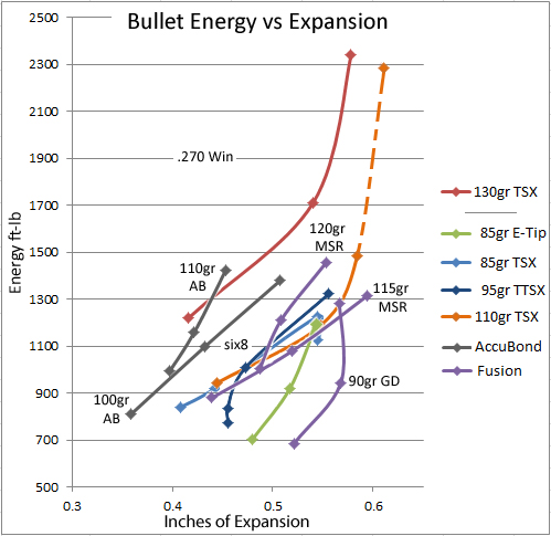

6.8mm Lead-Core Bullets that Expand
I redid the graphs above and edited the text to improve this section on bullet expansion. I realize this is a lot of detail. I also wondered if expansion of lead-core bullets like the AccuBond and Fusion MSR/GD would hold true to the paradigm that energy defines how much they will expand. At first the data didn't make much sense. I have always listed maximum expansion of the recovered bullet. The monolithic bullets are very symmetrical but that is not the case with the lead-core bullets, especially the Federal Fusion family. When I averaged bullet expansion based on the widest and narrowest side of the mushroom, the data correlated surprisingly well. So I have added a 4[SUP]th[/SUP] chart with the Nosler 100gr and 110gr AccuBonds (gray) and the Federal Fusion 90gr Gold Dot, 115gr MSR, and 120gr MSR (purple). I did it slightly differently and kept the bullet family a like color and labeled the specific bullet on the chart. Yes, the chart is a bit cluttered but it is worth a look.
90gr Federal Gold Dot - 2915 fps (Factory) [BC 0.236]
100gr Nosler AccuBond - 2700 fps (30.0gr AA2200) [BC 0.323]
110gr Nosler AccuBond - 2600 fps (29.0gr AA2200) [BC 0.370]
115gr Federal Fusion MSR - 2490 fps (Factory) [BC 0. 378]
120gr Federal Fusion MSR - 2550 fps (27.5gr AA2200) [BC 0.400] COAL 2.350"
Caution - this load worked in my rifle but this is no guarantee that it will work safely in yours.
Observations Regarding 6.8mm Lead-Core Bullets Expansion,
o The 100gr AccuBond always hit harder inside 200 yards. Now we know its design is slightly different than the 110gr AB and the 100gr expands more at the higher energy levels. Both bullets expand the same at lower energy levels.
A "group" picture of the AccuBonds showing terminal performance results can be seen at this link.
http://68forums.com/forums/showthre.../showthread.php?33178-6-8-SPC-Bullet-Performance&p=438749&viewfull=1#post438749
o The Federal Fusion bullets may have similar lead-cores and construction but they all perform differently. I would guess their nose shape and copper jacket design are responsible for the difference.
o The Federal 115gr MSR expansion is very similar to the Barnes TSX but has the potential for great expansion at higher energy levels. It will be interesting to see this bullet's performance when it is available as a component for handloading.
o The Federal 90gr Gold Dot's expansion is very similar to the 85gr E-Tip just slightly larger. I think their curves would match except the Gold Dot recovered at 200 yards had one of its 5 pedals that didn't fold back. The 90gr GD's expansion is well controlled, does not shrink much as energy decreases, and is well matched for the 6.8mm SPC.
All the Fusion MSR/GD terminal performance results can be seen at this link.
http://68forums.com/forums/showthre.../showthread.php?33178-6-8-SPC-Bullet-Performance&p=453355&viewfull=1#post453355
