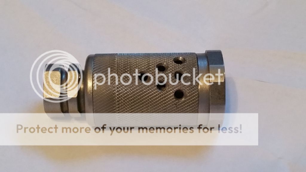

\n I am looking for 10 individuals willing to evaluate my new muzzle brake/flash hider (beta testers). Designed to reduce muzzle rise and recoil 60-70% . It does a great job of reducing flash: I hid the flash hider. It is louder than a target crown or a flash hider but not near as loud as a brake with big side ports. It is more efficient and will do the same job without excessive noise, and it won\'t blow dirt and noise in your face or the face of the guy next to you, even on a dirt berm.
\n
\n
\n
\n
\n
  • No gunsmithing - index the side holes with a crescent wrench
  • Index the side holes to compensate for muzzle movement left or right
  • No dirt in the face from those tactical berms, ask me how I know
  • Hide the flash hider
  • Design and easily make your own exit hole pattern (soon to be available)
  • 5.56mm caliber
  • 1/2 x 28 muzzle threads
\n
\nYou get a really good deal, in exchange for evaluating the brake/hider, and telling me what is good, bad, and ugly about this device. I am aware of certain short-comings, and I want to see what you think too.

    \n Very cool Randy. I have a freshly built 18" 5.56 sitting here with an A2 FH on it right now that would be a great platform to test this on. Count me in.

    \n The brake arrived this weekend here in Phoenix Friday evening. I got it unpacked on Sunday as I was at a match all day Saturday. I will be shooting it on my 3Gun rig Friday during my load testing for the new tube.
    \r\n
    \r\nThe machine work on this "sample" is very nicely done. Not much more would be needed for it to be coating/blackening ready as these testers are in the white. The design is pretty unique for timing the gas direction and I really like that on inspection. I\'ll shoot it on the semi for now and then in a couple weeks I\'ll slap it on an M16 and see how it likes Rock & Roll. I will take it over and have it Cerakoted in the near future only because I know a guy.
    \r\n
    \r\n
    \r\n
    \r\nReports to come later.

    \n So far all the rapid sustained fire I have tested has burned the paint off, lotsa smoke. I will be interested to know how cerakote does on your M16!
    \n
    \nPlease use Loctite 620 Hi temp retaining compound (or equivalent) on the front nut, or it will come loose after sustained fire. Check the nut tightness before firing.
    \n
    \nGreat picture, post more, I could use \'em!

    \n I spent about 8 hours at the range Saturday with four different rifles. I shot the WOW extensively from the bench. Using a front pedestal and rear bag the rifle tracked perfectly to the rear. This is on a light gun. Compared to my other 223\'s I had no mule rise. I was able to observe the target shot to shot never loosing the sight picture.
    \n
    \nI left my "blasting" ammo at home setting on the counter so did not get to run and gun it. That will be cured this week. The are I shot was covered up this weekend so mid-week I will go out and set up a movement course and see how it function for me. I\'ve got a timer so I\'ll see if the splits are any different vs. my regular AR\'s. I can say that with the combination top ports and linear comp I am very impressed already. I can also say that accuracy was not effected adversely as I got some very good groups during the testing.
    \n
    \n I didn\'t have any issues with mounting or the keeping the front nut tight. I used Peramtex High Temp thread locker and it seems to be doing fine. Some of my test groups were not particularly slow so it did get hot.
    \n

    \n This looks like it\'s going to turn out to be a really good. Any plans for a 6.8 version?\n
    \r\n \r\n
    \r\n
    \r\n
    I was planning a 5.56 and a 30 caliber production version. I could do a 6.8 version, but not until I do a production run. Which I don\'t have scheduled yet.\n

    That\'s good to hear, I know a 6.8 is a niche market compared to 5.56 and .30 so I know it may be awhile off.\n
    \n
    \n
    \n
    \nGreg
    \r\n \r\n
    \r\n
    \r\n
    Greg, mule rise = muzzle rise? When you go for the run and gun, be prepared to adjust the top ports to compensate for any muzzle movement left or right. And check the front nut tightness frequently during your testing.
    \nMany Thanks for testing it out!
    \nRandy\n
    \r\nMany Thanks for testing it out!
    \r\nRandy
    \r\n \r\n
    \r\n
    \r\n
    LOL. Well it didn\'t kick like mule so there wasn\'t a lot of rise there.
    \r\n
    \r\nI understand the port adjustment. I have a DTA MilBrake set up on an M16 that shoves it down into the hand from the left, I\'m a lefty, and it helps greatly in FA work.
    \r\n
    \r\nI\'ll check that nut up front as I go for sure. The testing is always fun.
