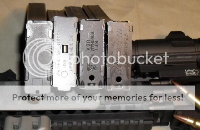

    I've got a few different 6.8 SPC magazines on hand for an un-biased review. The mags being reviewed are the Bushmaster 25rd 6.8 SPC magazine, Barrett 30rd 6.8 SPC magazine, PRi 25-rd 6.8 SPC magazine, and C-Products 25rd 6.8 SPC magazine.
    Out of these four magazines, the hardest finish is a toss-up between the Barrett magazine and the C-Products magazine. The PRi is the runner-up with the Bushmaster trailing behind. The Bushmaster magazine finish is comparable to the USGI anodizing which can be scratched with a finger nail. After a few reloads the finish starts to wear through and look shiny. As far as glare goes, the Barrett and C-Prod reflect the most light. Between the PRi and the Bushmaster I feel that the Bushmaster has more 'sheen' since the PRi has a somewhat metallic finish and the waffle shape breaks up the glare. Between the Barrett and C-Prod, the C-Prod has more of a satin finish so it has less 'sheen' than the Barrett. Notice the difference of the mag catch cut-outs in the various magazines pictured. The C-Products mag catch cut-out is ramped on both sides, this makes for a very positive mag catch engagement with an audible click as the catch finds the recess.
    As for the welds and feed mouths, its easy to see PRi is the clear winner. There are no visible welds or seams at this junction, and the PRi has the lowest feed mouth of any mags pictured. The Bushmaster is the worst with the highest feed mouth, and it occasionally got caught up on case mouths while feeding.
    The welds on the back show that the C-Products magazine appears to be the most sloppily constructed. Some of the spot welds are raised up, the steel seams show wrinkling, and the mag has noticable flex when squeezed with your fingers. The C-Products magazine also exhibits the greatest distance between the feed lips, though I'm uncertain of what effect it has on function.
    As for the followers, you can see that the Bushmaster and C-Products followers and mag bodies are essentially identical. If you look at the feed lips they both show a 3-steps down shape in their side profile picture. Both mag bodies are marked 'SS' for stainless steel. Their floorplates are identical which you will see in the next picture. However, if you look at the seams inside the magazine, the RED ARROW shows that the C-Products magazine seam is not pinched flat like the others. This is what prevented this magazine from seating the 2.3" OAL cartridges. I am uncertain if this occured while shipping or if the mags left C-Products in this condition. Both magazines I received showed this issue. If their mag bodies are in fact identical to the Bushmaster mag body, then a properly constructed C-Products magazine should feed the 2.3" OAL cartridges with no issue.
    The advantage to the PRi magazine body is in its construction--this juncture has no welded seams so using a thicker metal still achieves a greater I.D. over the welded seam construction of the other magazines.
    These are the floorplates. You can see the similarity between Bushmaster and C-Products floorplates. To remove these plates for mag cleaning/maintenance, you need to bend the tab at the bottom up enough and use a flat-tip screwdriver to pry the floorplate away from the magazine. The Barrett floorplate tab all the way on the left is different in that the tab is bent into the magazine body--I'm unsure of how this one is disassembled. The PRi magazine is the easiest to disassemble, it uses a locking plate underneath the floorplate which can be depressed with a bullet tip, then the floorplate slides right out.
    The overall feel of the magazines gave favor to the Barrett magazine followed by the PRi magazine. They do not rattle when empty or loaded, and feel solid. The Bushmaster and C-Products magazines felt the flimsiest and rattled when empty or loaded. The Barrett's steel follower felt the slickest out of all the magazines I tested. The Bushmaster magazine with the brown follower was the runner up, followed by the C-Products magazine and the PRi magazine was the worst. The PRi mag was the most difficult to load in that I encountered some binding when I did my capacity tests.

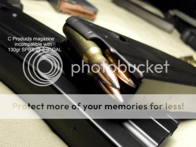

    My second test was to see which magazines could tolerate ammunition with a maximum OAL of 2.3".
    Bushmaster passes the test, in this picture it is holding 10 rounds of 130gr SBPT @ 2.3" OAL.
    PRi passes the test, in this picture it is holding the same 10 rounds of 130gr SBPT @ 2.3" OAL.
    C-Products mags would not hold the rounds, in the picture you can see the meplat of the 1st round is hung up on the seam in the front of the mag body.
    Barrett mags would not hold the rounds either, you can see the meplats hung up in the same fashion as the C-Products magazines.
